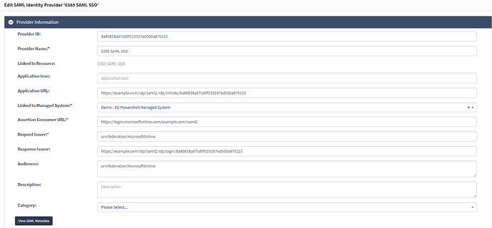

When I use the following as the Assertion Consumer URL: https://login.microsoftonline.com/<tenant-id>/saml2
I receive the error: AADSTS90121: Invalid empty request.
If I instead use: https://login.microsoftonline.com/login.srf
I get: AADSTS90019: No tenant-identifying information found in either the request or implied by any provided credentials.
It seems like Azure AD is not recognizing the tenant context or the request is malformed. Could you advise on the correct Assertion Consumer URL to use in this SAML2 setup with Azure AD?
Yes, that’s correct –dmfiam.ch is a federated domain in Microsoft Entra ID (formerly Azure AD). I’m currently working on configuring OpenIAM as the Identity Provider (IdP) and Microsoft Entra as the Service Provider (SP) to enable SSO.
I see the same example.com in your federated domain configuration (for dmfiam.ch )
What domain are you using instead of example.com in this configuration, is this federated domain (dmfiam.ch) or OpenIAM domain name ?
