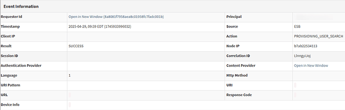

EDIT:
I was able to get this working now with my modified script by ADDING Object Primary Key for User in the connector configuration. I set it to MailNickName in the Managed System configuration and changed the Source Attribute Name in the Azure Auth Assignments synchronization config to MailNickName as well. I tried UserPrincipalName first (as that was the default in the Source Attribute field) but it created an orphan account in the system. Keep in mind, this is all with my modified connector.ps1 and azureoiam.ps1m scripts using MS Graph.
I should also mention I had to edit the AzureTransformation.groovy script as the default one was was generating an error. I couldn’t even save a copy of it to edit.
