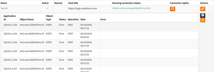

However, we are getting a failure result in SAVE_CONNECTOR_RESPONSE in User History.
No error message showing in both User History and Managed System connector replies, it just said ERROR.
When I check the logs in the salesforce container, it shows redirect_uri_mismatch and redirect_uri_missing.

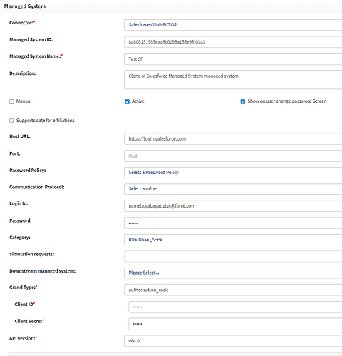

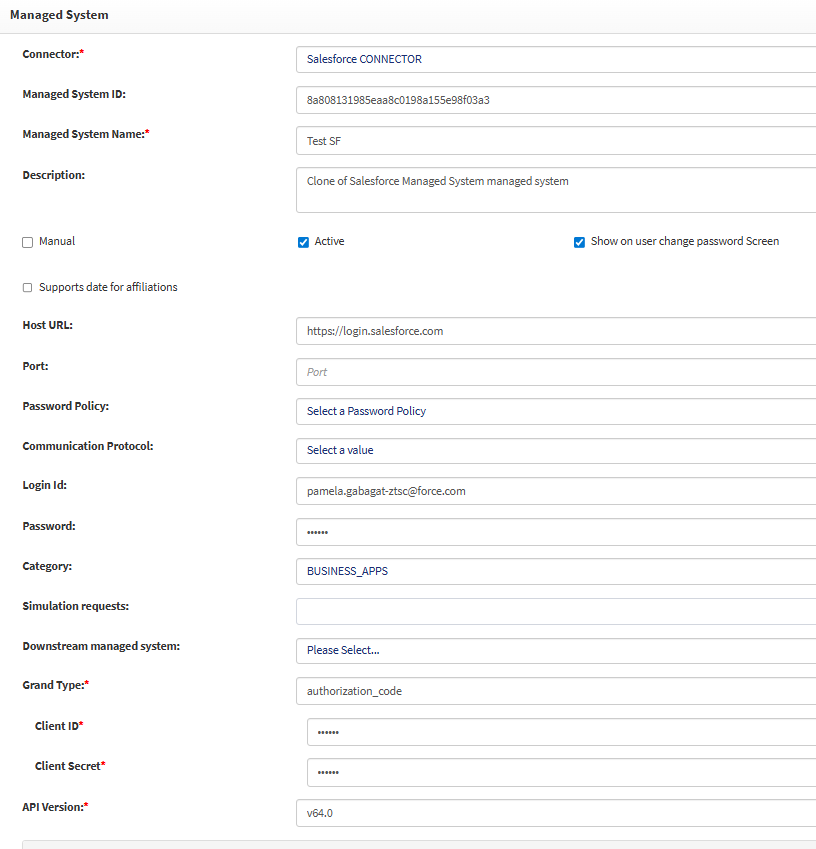

This is what our Salesforce MS looks like.
Client ID and Client secret are both from the Connected App we created in Salesforce.
Thanks in advance from your assistance and support.

I have modified the Salesforce Managed System as per the document guide. However, we’re still facing the below errors.
